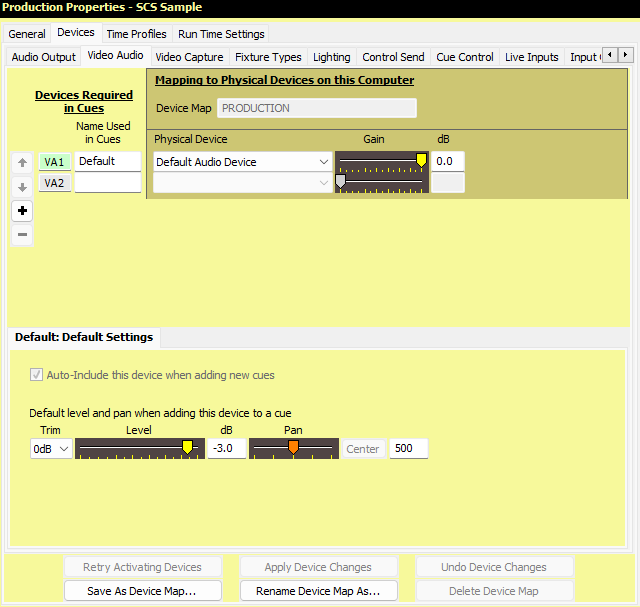

Here's an example of the Production Properties for Video Audio Devices:
Initially there will just be one Video Audio Device displayed, which will have 'Default' as the Name Used in Cues and will be mapped to 'Default Audio Device', which is the Windows default sound device.

Device Number (VA1, VA2, etc): If this number is displayed with a colored background (eg see VA1 in the above screenshot) this indicates this device is the 'current' device for the Sidebar Controls to the left, and for the 'Default Settings' panel displayed below the device list. To make a different device the 'current' device, click on any field in the line for the required device, or on the Device Number itself.
Sidebar Controls: Controls are available to enable you to easily change the order of the devices as explained for Audio Output Devices.
Name Used in Cues: Enter the name you want to use for the audio output in your Video/Image cues.
Computer-Specific / Device Map-Specific Fields
Device Map: This is a display-only field showing the Device Map currently selected for this production in the Audio Output Devices tab.
Physical Device: The DirectSound device assigned to this Name Used in Cues. If you select 'Default Audio Device' then this will map the Name used in Cues device to the current Windows default sound device. This handles situations where an external audio interface may or may not be connected, and where Windows may change the default sound device accordingly. 'Default Audio Device' uses whatever audio device is currently assigned by Windows as the default.
Gain and dB: This is like a Master Gain Control for this physical output in this Device Map. Normally you should leave the gain at the default setting of maximum gain (0.0dB). See the corresponding property under Audio Output Devices for more info.
Default Settings
Auto-Include this device when adding new cues: If this checkbox is selected then whenever you add a new Video/Image Cue then this device will automatically be included. One and only one Video Audio Device may have auto-include selected as Video/Image cues only support a single audio device. Note that this property only affects future cues added - changing the setting has no effect on existing cues.
Default level and pan when adding this device to a cue: This gives the trim, level and pan to be used when adding this device to a cue. You can, of course, subsequently change the trim, level and pan in the cue itself.
