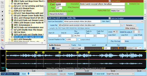

Here is an example of an audio file cue containing SCS Cue Markers.
The audio graph currently shows five SCS Cue Markers.

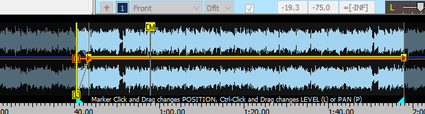

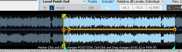

SCS Cue Markers, similar to Level Points, cannot exist outside the 'Start' and 'End' Points set on an audio cue, also the 'Start' and 'End' Points cannot be moved past an SCS Cue Marker.
Below shows the 'Start' Point moved along the audio cue until it meets the cue marker position.

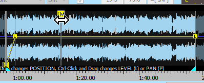

2. Slide the SCS Cue Marker by Clicking and Dragging the Marker
Left click on the marker header to show the Cue Marker information and hold the mouse button down (mouse pointer will change to left/right arrow) and slide the marker Left or Right.
The Marker may only remain inside the boundaries of the 'Start' and 'End' Points

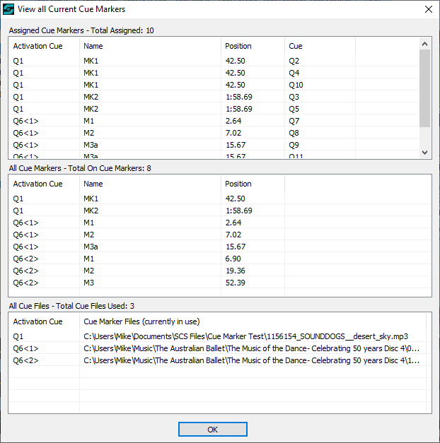

View all Current SCS Cue Markers
Selecting this menu option will display a window showing the following -
1.Active SCS Cue Markers used for 'AutoStart' another cue already assigned
2.All SCS Cue Markers that exist on all audio and video cues
3.All Cue Files that contain SCS Cue Markers
Other information includes the marker <Cue>, <Activation Cue>, <Name> and <Position>. This is a view only window and cannot be edited.
Additionally, depending upon the your license, the remaining number of markers that can be added and the remaining number of audio files that can have SCS Cue Markers added to them is shown.
