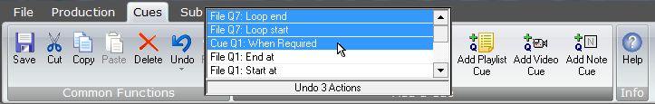

The following image shows an example of undoing some changes. A list like this one is displayed when you click the Undo or Redo button.
Undo
In this example the most recent change made was to set or adjust the loop end point of an audio file in Q7. The change before that was to set or adjust the loop start point of that same audio file. The third most recent change was to the when required field in Q1. The fourth and fifth most recent changes were to the end at and start at points of Q1. The scrollbar on the right enables you to see more changes. The list is restricted to the last 100 changes to prevent a memory blow-out during a large editing session.
The cursor (mouse pointer) is hovering over the third most recent change, so SCS highlights all the changes back to that change, and displays the message Undo 3 Actions in the panel below this list. If you now click the mouse while the cursor is over that third most recent change, then the those three highlighted actions will be undone.
